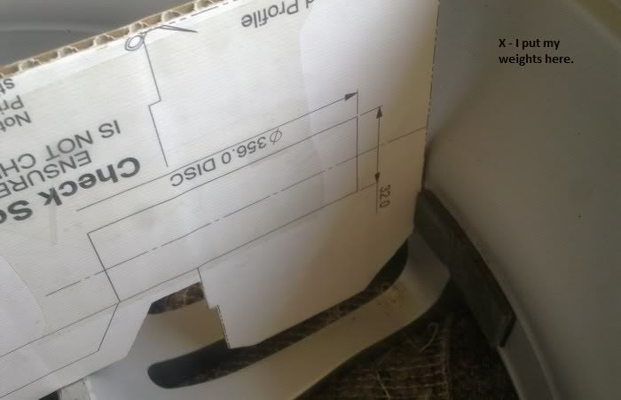

What do you mean exactly...? That your balancing weight was relocated to that exact place in the rim was clear for me. I'm not sure if the relocating of the weight will be enough to make my 18" M164 winter wheel fit. The AP measure template hits the inner side of my M 164 wheel with 0,5 -1mm.
my balancing weights are at X.
I don't think you should rely on the template. Best to use the caliper when it arrives.

I hope the AP template is 2mm off en that the front caliper fits with my 18" M164 winter wheels the same way as with the oem 18" Z4M wheel. :? If they don't fit then I will sell the winter wheels (hopefully not).
