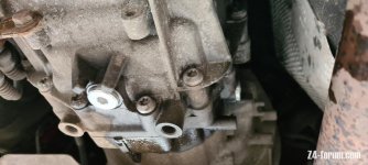

As the many guides on here say it is as easy as:
  • Warm up gearbox oil (15min drive)
    Remove filler plug
    Remove drain plug
    Re fit new drain plug
    Fill until oil appears at filler plug
    Fit filler plug
    Torque up (35nm) done!

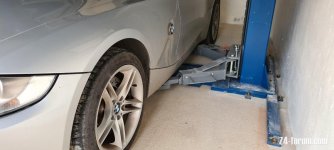

I had looked at doing this using axel stands, but didn't fancy it. One vehicle ramp I tried, I could not get the arms in position to lift up. The Z4M jacking points are 104 cm apart and the lift I was using could not get the arms close enough to fit. My car has a 140mm floor to front bumper clearance and the jacking pads are 110mm so it was pretty tight.

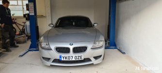

On Friday myself and a mate helped my neighbour fit an install a car lift. It was pretty straight forward. bloody heavy though (Adhering to C19 safety obviously) and today it had been tested (With his wife's A4...) so I reversed my Z on to the ramp but the jacking pads were about 10mm too low for the car lift. As we started talking about using planks of wood under the wheel to lift the car or a trolley jack (Which I had lugged over) I realised I could just lift the body by the wheel arch and slide the arms under (Why did I not think of this previously...)

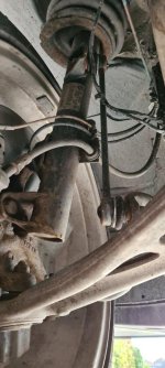

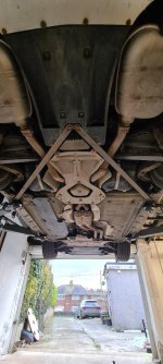

So that was it, car on, and raised! While the WD40 was soaking on the filler & drain plug I had a good look around and (I'm no mechanic or expert) the under car seemed, well a little rusty. Obviously like myself the previous owner had the car outside. more on that later.
(Am I missing a black shield on the RH side?

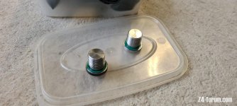

The existing plugs looked new, but I used new ones anyway as piece of mind. The oil filler worked a treat and it took just under 2 bottles of fluid. It really was a quick job.
new
old plugs

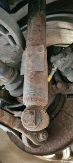

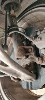

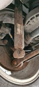

Now the under car bits. The shocks I'm surprised were not picked up at the service or last MOT. Any suggestions on replacements will be greatly received and any tips.
I wouldn't be overly concerned with the rust level, for a 14/15 year old 90-100k car that's probably lived outside or at least seen regular wet use, it seems about par for the course. As long as the chassis and main mounting points are solid then those are all bolt on components that can be easily refurbed or replaced.
You could easily 'touch up' the shocks and camber arms with a bit of time and paint or you could say sod it and change them for new parts as they're likely past their best anyway. As this is the Internet and it is customary to spend others money, I vote full refresh with some spangly coilovers as some visual gratification!

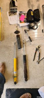

Hadn't posted in a while so thought I'd do a quick update.
So a few weeks back I changed the rear shocks for B4s. Initially it sorted out the rear height, then the next day it was back down low. So they are lowering springs on there.shocks R.jpgshocks R 8.jpg
