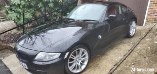

Zedebee said:1. We love photos.
2. Have you run the TPMS reset procedure on changing the wheels?
From memory: be at a standstill with engine running, hit the TPMS button above the ashtray until the indicator in dash turns yellow, start driving. Light will go out by itself, and new pressure is set as default.Fred Smith said:2. No. Will need to google!
Fred Smith said:Looking good. I like the MV3s, quite a lot actually... but I prefer MV2s for the "classy" look, but I am leaning towards OTT, not classy!
The MV3s are pretty scruffy up close, and the almost-new tyres are pretty much budget... but not too bad as a freebie to be chucked in when I paid £3,300 for an E91.
