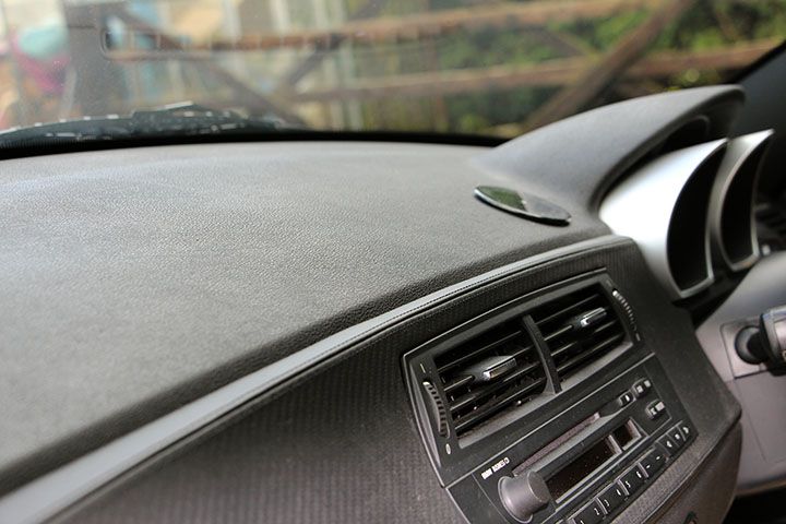

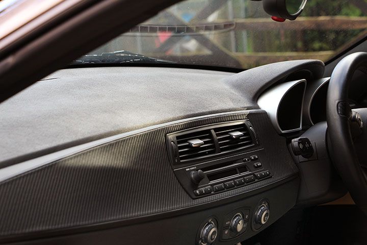

Removed the horrible circular metal sat nav base that came glued to the dashboard when I bought the car. I've always worried about removing it, thinking I would be left with a horrible mess, and the 'Z' dashboards aren't the easiest to clean! But no, it came off without any trouble, and now I have a dashboard with lovely clean lines, happy days!
Before
After :D
