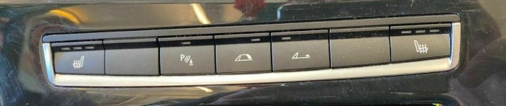

Replaced my worn roof buttons with the new set I picked up on Ebay. Nice easy job.
Before:
Gear lever plastic surround just pulls upward, as does the lever itself. 2 electrical connectors to pop off:
Then remove further connectors for ash tray, iDrive, hand brake and mode selectors - the ash tray also needs to be removed to get enough access to be able to remove the roof buttons, this is held on with 4 torx screws:
Replacement buttons fitted (they're perfect :thumbsup:), ash tray added back on:
And back in the car.
