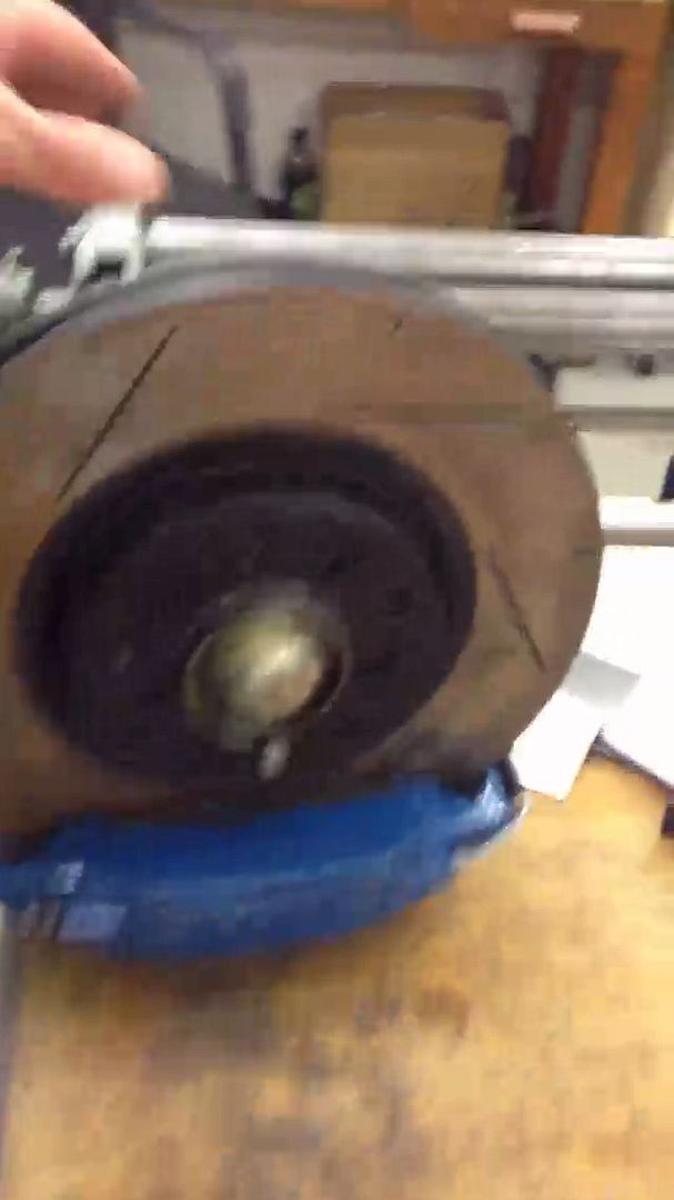

Well i had done lots of measuring and shimming and calculating. AND?????????????????? It has all bolted together and seems to work!! I was a bit off in one place and had to machine 0.7mm off of the lobes. but it all looks good and spins freely now.
This is a video. Click and watch if you want to. It is just a disc spinning!!
Looks nice.
Nice heavy bracing on the lugs. The only thing you have to check is if the caliper can match the thickness of the disc. So that the pistons don't pop out when the pads are virtually worn.
But being calipers from a production car and not some bbk with extreme thickness discs I cant imagine that that'll be a problem.

Thanks for the tip mate. The stock alfa and BMW discs are the same thickness so shouldn't be a problem.
Yeah i will give them a spruce up before they go on finally. Not sure about the stickers. It seems a bit too hey look at me. These where a performance not a visual upgrade for me.

Is it a 300 or 325mm disc btw?
Machine monkey said:
you might be right. I am going to make sure they work properly first. It seems like bad juju to be thinking that far ahead!
325mm

As much as I admire your bravery in home making braking components I can't help but think it would void most standard insurance policies.
Why would it void the insurance policy? Does it say that putting on different brake parts voids the policy? I think lots of you brits drive around with bbk's?
I don't think you have a system like the germans with their TüV schein?
I think when it doesnt say specifically in the policy, the only thing you have to pass is MOT.
Well if it's declared and they don't ask any more questions then great but if it fails they sure aren't going to pay out. At least when you buy a BBK it has been formally designed and tested.
This is also formally designed and tested?
As those are very empty words.
And when MOT'ed also legally tested imho. Unless it is specifically mentioned in the policy or law.
MOT test is paltry and lacks detail so wouldn't spot this.
Measuring up and chopping something together is not on the same level of 'design'.
There's a small notch near the top bolt in the picture on the right hand side which could act as a stress raiser and propagate a crack. In all likelihood the whole thing will be fine but it's not without its risks.
If it was me I'd directly say to my insurer 'will you insure me for my brakes which include a home produced bracket'. See what they say...
Compared to something perfectly road legal like a Locost / Haynes Roadster with a completely home-made chassis this is really nothing to be concerned about.
