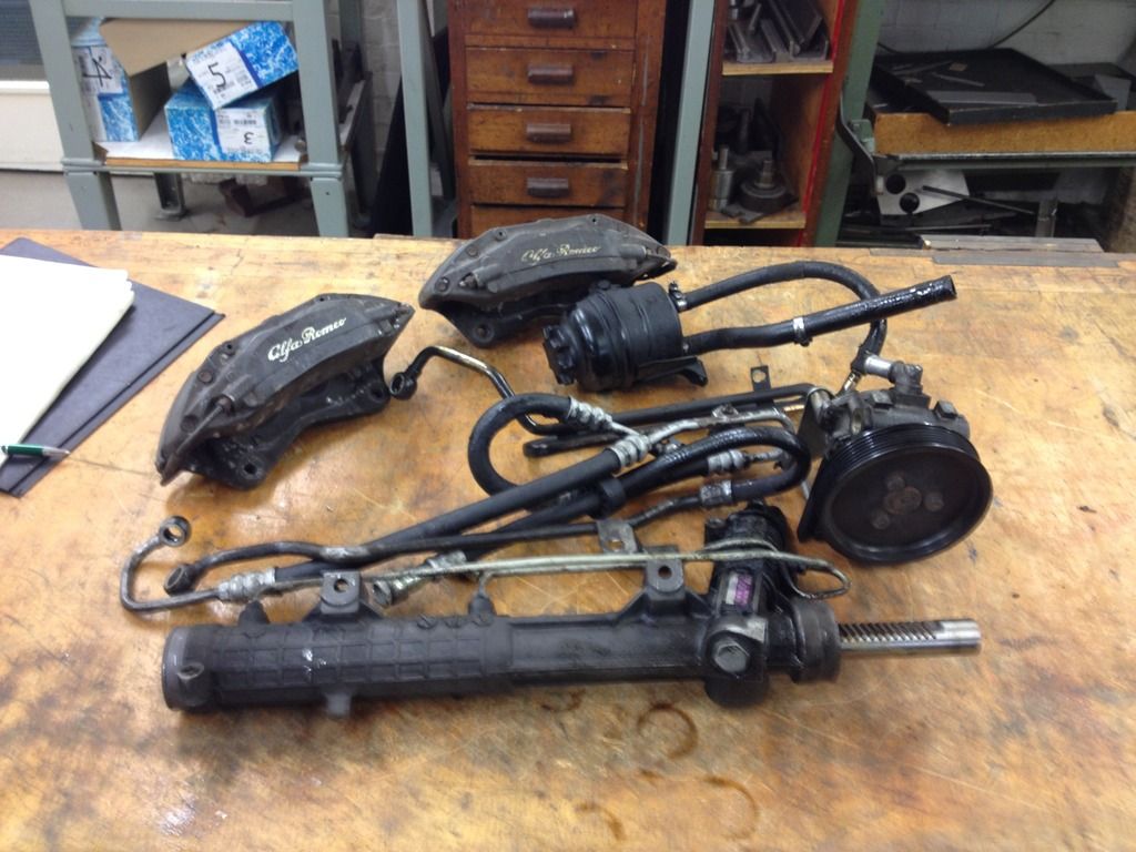

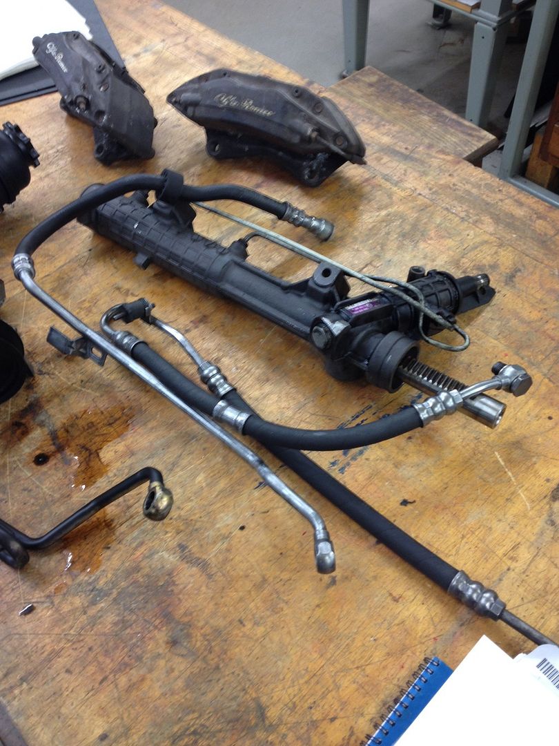

And i have just become the proud owner of a purple tag steering rack and all the ancillaries needed. So i can convert my car to a proper steering system. The best bit of all it only cost £100 for the lot.

Got the bits for the steering convertion off Facebook
And got some big brembo calipers from eBay
All in £275 couldn't be happier to have a pile of dirty bits to clean up in my lunch brakes next week.

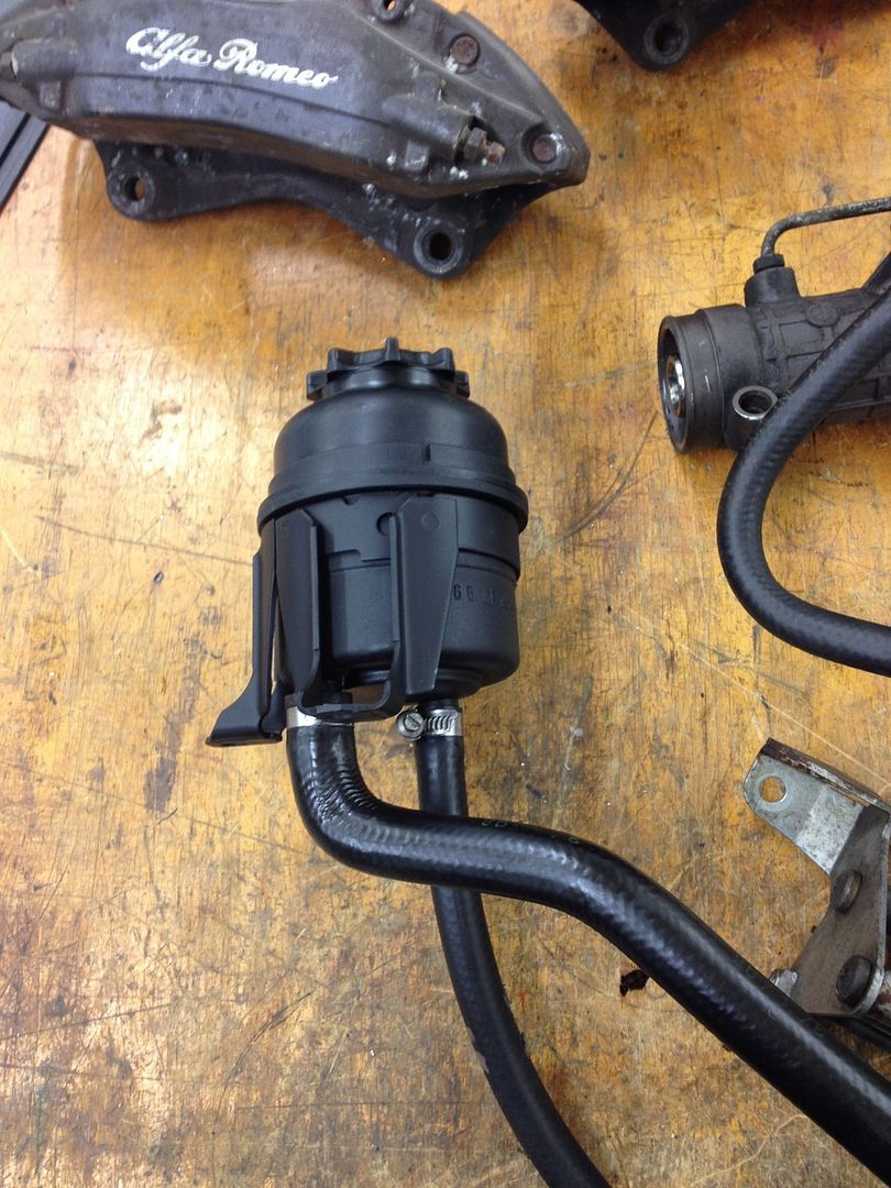

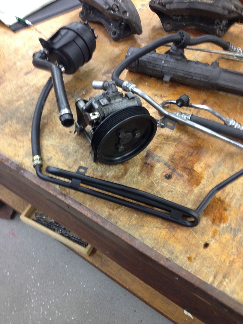

That was a productive lunch brake. The rack needs another clean and i haven't touched the calipers. That is for lunch and coffee brake tomorrow. But the rest came up quite nice.
have you measured the widht of the rack?
So the distance between where the tie rods are screwed in.
That has to be exactly the same as the current rack. If it's not, then you get different alignment in corners and on bumps, under braking etc (every instance that the suspension is compressed or extended.
