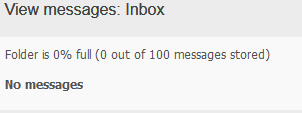

I can't seem to send you a PM to discuss further (likely as I've only just signed up!) so please feel free to send me one![]()
