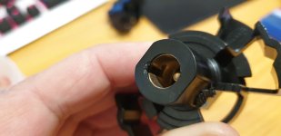

I now have my headlights out to both clean the xenon lenses as well as upgrade the angel eyes. I removed the old bulbs which required a little force but exposed the BA9S fitting.
I have bought these replacements over here in NZ with a focus on maxing the lumens and being canbus free so I don't get any errors. https://www.trademe.co.nz/motors/car-parts-accessories/performance/bulbs/listing-2217196317.htm. These are 5w so half of the original 10w filament bulb and should be a truckload brighter!

Yes, there is a blue filter in the assembly. This was taken from another posting:
https://www.zpost.com/forums/showthread.php?t=724153&page=1
