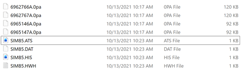

No, it's not what from the HIS file says
;Zusbauhistorie vom 26.04.2005 12:58
;SG-TYP: SIM85
;ZB-ALT ZB-NEU FREIKENNUNG
6935920,6965147,00,HK
6928570,6935920,00,HK
6938263,6939810,00,HK
6939810,6962766,00,HK
6927552,6938263,00,HK
6928953,6935919,00,HK
6935919,6965146,00,HK
6939811,6962767,00,HK
6938264,6939811,00,HK
6933933,6938264,00,HK

Your list is not in order. Follow it through, each time you try to update it shows you a new number. Then find that number and see what it takes you too.
As I tried to say, if you use WINKFP it will always update to 2767. You can try it by putting in any of the other numbers instead. It will still give a message saying it’s about to update to 2767.
Ah what would I know eh?
It's a daisy chain, dude... once the number on the right does not show up on the left, it is the final version.
For example, ZB number 6935919 shows up on the right and left, the right besides it is 6965146 and 6965146 doesn't show up on the right, that means it does not have next chain version. If your ZB number is 6935919 winkfp will ask you to upgrade to 6965146. That's why in winkfp and daten there is a 6965146 option, and 6965146 does not update to version 2767. (Unless you manually select it and flash)
This method apply to all E-chassis BMW daten files.
