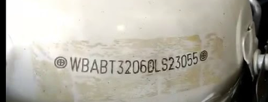

Try this:
flash the ZB file corresponding to your car VO, then do factory coding using factory profile
you can check using real oem or just simply look at your VIN number
For example WBA"BT32"060LS23055
