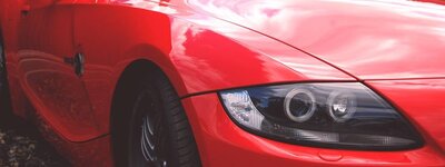

Just for you lot I took the battery off my bike. First attempt at taking a pic:
If they look wonky they are lol. Went cross eyed when I moved the headlight :lol:
Facelift xenons now using factory diffusers. Just waiting on a pair of smaller rings I've ordered as the inner halos are smaller. I now have a full set of diffusers and a pair of 80mm halos spare. Might buy another pair to make a full kit and sell it on here.
