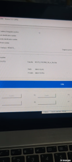

Z4 3.0i to 3.0si with bimmerlabs flash!!
I just installed 3 stage intake manifold on my N52, then flashed the file from bimmerlabs with RSA delete and 3.0i to 3.0si tune using ICOM
Both disa works, now I have upgraded from 3.0i 210hp to 3.0si 265 hp!
