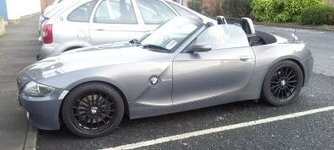

Have really enjoyed reading through your postings - great work and your Zed looks fabulous. :thumbsup:
Have 32s on my Zed as winter wheels (in black). have had many people say they like them - I'm still not sure. They are 6.8lbs lighter than the originals I use in summer - that's a total of 27 lbs saved.
:driving: :thumbsup:
Hi paul and thanks for your comment. I try to keep it good and prep it for next summer season so i dont have to spend summer in garage, drive and wash only..
I have that feeling about style 32 too, i dont know if they look good. Style 108 would be much better in my mind.. (expensive..)
