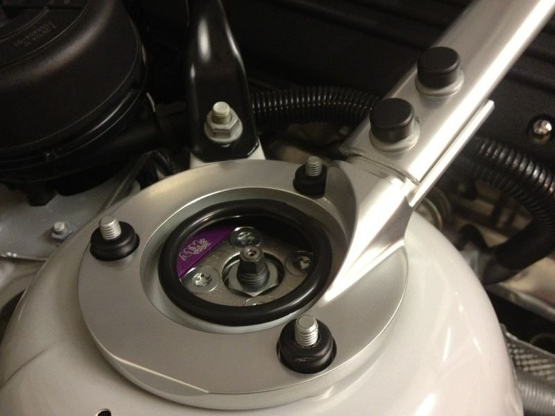

The solid uniball billet topmounts/camber plates introduce further NVH but really transmit lots of GOOD detail as well.

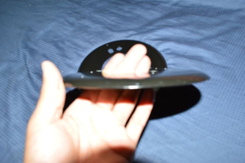

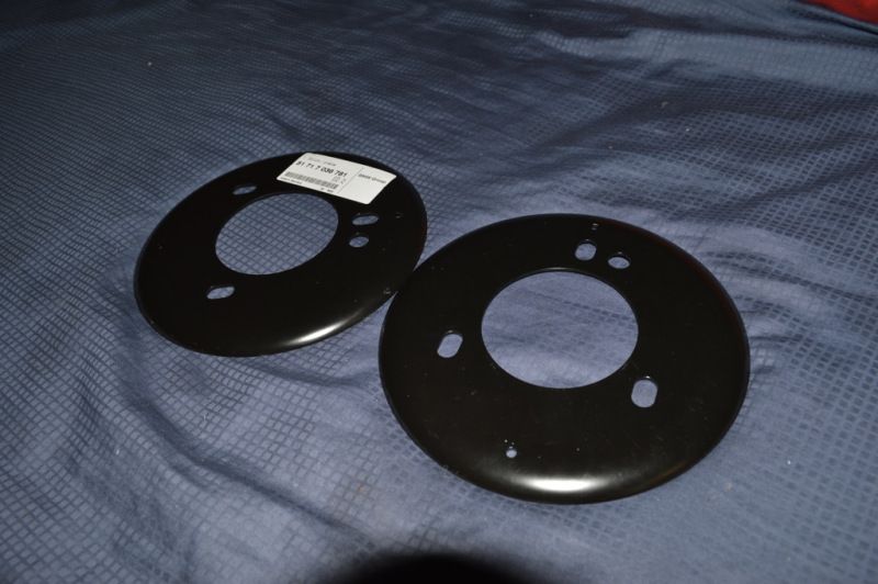

These setup NEEDS the reinforcement plates to protect and spread the load across the turret (cheap insurance imo)

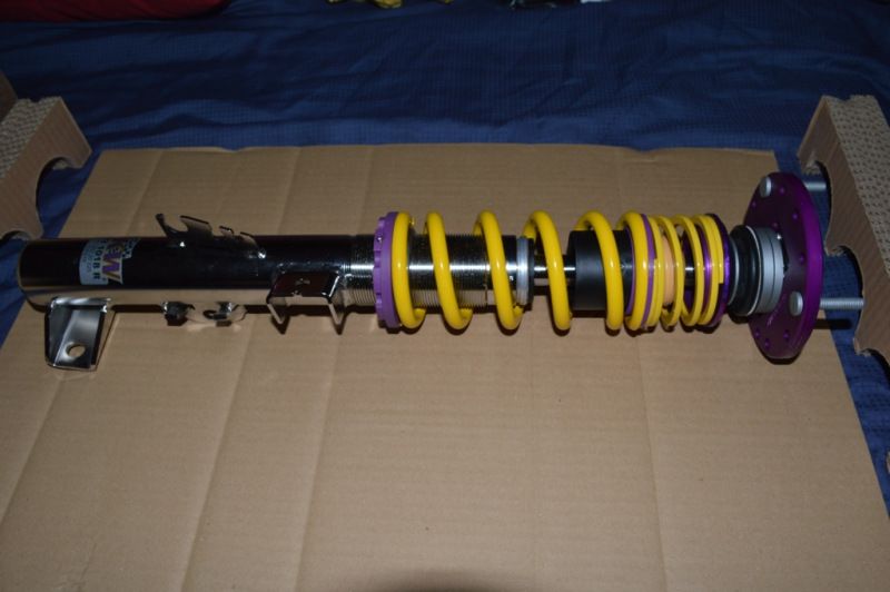

The quality of the kit is literally second to none, its a shame its hidden under the car, its porn!!

Further weight reductions made with the kw clubsport, each damper and spring is lighter than stock.
The dampers and completely rebuildable....

if you have a strut brace you need to special order longer studs which then need to be pressed into the top mounts.

reinforce plates and rear top mounts

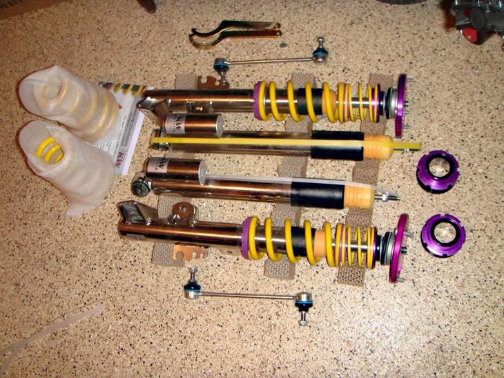

some porn... (pre clubsport)
