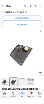

As for mine, then I'm happy, just waiting for my new subwoofers to arrive. As I have the HiFi ones I'm just changing the speaker and not the housing. So in doing that I can get away with buying the subwoofers from the E70, as the actual speakers are exactly the same inside. Four screws each and a straight swap over.
Average price of a used E89 Top HiFi subwoofer is around £150 each. The E70 subwoofer (exactly the same part number for the speaker inside) cost me £30 each!! Quite a saving
