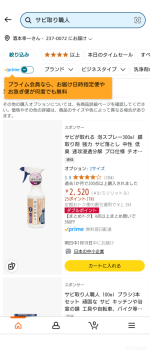

The car I bought was used in a snowy region, so it has a lot of rust. In addition to the muffler, metal parts such as screws and arms have rust and need maintenance. I found a rust inhibitor on Amazon, so I'm attaching a picture.

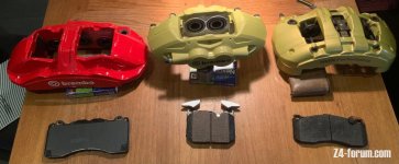

Attention moves to the front end..the existing BBK..the trusty E82/E90 6 pot Brembo with 338mm x26mm discs removed for the new owner..
Current plan is still to fit the big Shelby Mustang Brembo 6 pot (bigger pots) with M2/M4 380mm 30mm discs..
However here’s the F series M Performance caliper (340m with adapter for 380mm discs)…
Also trial fit of 380mm M2 front dust shield..will need a little work but 3 out 4 holes line up..
The M Performance caliper is slightly lighter..the old Brembo s bit chunkier..but it does have harmonic weighs bolted on..

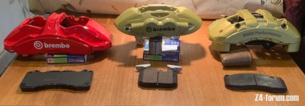

I'm using the E90 Mpkg brembo on the far right with a different color, and when I checked with the shop, it seems that this caliper doesn't fit 360mm and the pad area disappears
