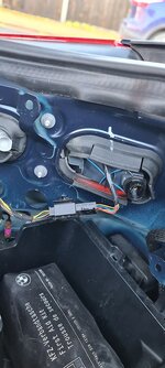

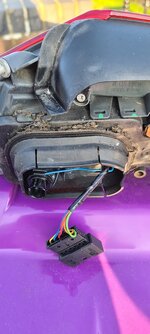

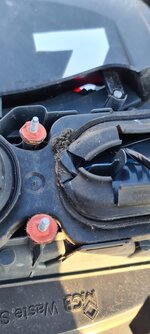

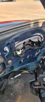

Combination of last night and this morning, but I removed my rear lights to de-crud the gaskets, silicone sealed the outer shells (got water bubbles getting in when I pressure wash it- more to follow on that!) so they have a bit better a chance at continued life and re-fit them properly as it turned out they weren't actually fit properly.
The gaskets needed a good long soak in Fairly liquid and a bloody good scrubbing, layers and layers of hardened muck in the crevices!
Some horror shots:

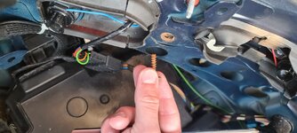

What’s that screw doing holding the light cluster?

So, through this process it became apparent that cluster has been replaced at some point in it's past with one from mid-2013 (7191776-11), whereas my car is an early 2010 (other cluster is a 7191775-07) which explained why when I renewed some bulbs previously, there was a W16W where the other side had a H21W - weird change to make but whatever.
The -11 is new enough to be missing the third stud/nut combo (but isn't new enough to have the gasket with the screws, which I think was introduced with the -12) and it seems that a previous owner/garage tackled that newly introduced water ingress point by sticking a self-tapper where the nut would have gone šŸ˜…
I stuck it back in for now after cleaning the screw up a bit but plan is to clean up the rust it's left behind (hoping it's not gone through the paint!) and apply a more appropriate (TBD- was thinking just some electrical tape) barrier in it's place in the near future
