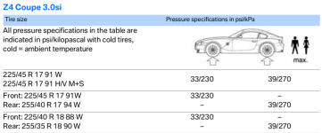

I also have staggered setup on my coupé. Here's what the owner's manual states about tire pressures for the coupé with the different stock wheel setups.
2.1 bar at the rear is quite a bit lower than the recommended from the manufacture.
I will play around a little with different tire pressures before I consider changing the suspension.

I run the M tyre pressures on mine (remember the M has non runflats from the factory) of F30 R32. I found these to massive improvement over the standard 3.0 pressures listed when I moved to non run flats

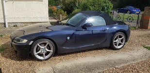

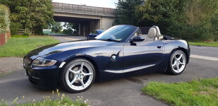

A few months back I put Eibachs back on my car after trialling SE springs since last year and not liking them.
Today I took things one step further, so going from this with SE springs
to this, Eibachs and new wheels
Sorry not the best photos

Car looks great Mack :thumbsup: What are the wheels and tyres, sizes and offsets etc ? Thanks, Si

Thanks Si,
They're 18" Zito 935's. Fronts are 8.5 et 35 and the rears 9.5 et 40.
I've always loved them on a Silver Zed since I saw them on an old forum members car in these two threads
https://z4-forum.com/forum/viewtopic.php?t=57131
https://z4-forum.com/forum/viewtopic.php?f=41&t=77861&p=1146626#p1146626
I just need to get some domed BMW stickers/badges for the centre caps and some nice wheel bolt covers.

Thanks Mack. They do look the business :thumbsup:
