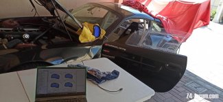

Couple of pics of the new Chase Bays master cylinder install.. the adaptors were a frikking nightmare, ended up making my own. What a beautiful piece of kit from chase bays.. all new banjo braided lines. ABS deleted.
:thumbsup:
Previously the willwood master wasn’t putting out enough pressure (and its Wllwood’s biggest) for my liking, so I contacted Chase Bays, excellent guys to work with and super knowledgeable. Easy to recommend them. I’ve been putting this job off for about 2 years.. I didn’t end up using their Clovis device as I had already calculated and modded the moment around required for this on the brake pedal to work properly, just that willwood didn’t provide the desired results, (not sure if that was due to the abs still being in place or just not enough size in the valving.) either way, all sorted now. :thumbsup:
https://www.chasebays.com/
(Edit, just for completeness, make no mistake, that Chase Bays unit is also a customized valved Willwood unit)
So in the final pic there is there willwood resiviour on the right for the clutch and the brake master just to the left and below. Super stoked.

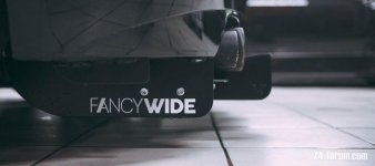

So, yeah not dead in the water, but just life getting in the way of things.. not too much in this pic you might think, but with this car, EVERYTHING is custom. Everything.. even the frikking tow hook won’t fit as the carbon bumper sticks out
Further than the oem bumper. Absolutely crazy. So this is my solution for an extension.. easy enough to make, lucky I’ve for a good tap set and drill press.
