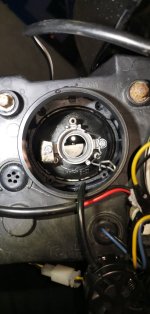

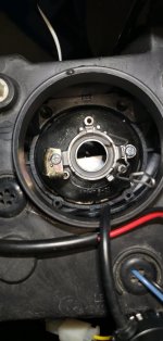

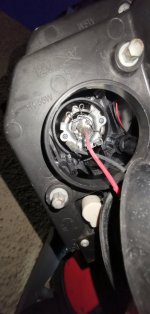

Hi Lucas!
Here are the pictures as requested:
Projector mounting (H7 bulb holder):
Main/High Beam mounting (H1 bulb holder):

It looks to me like the projector can't be easily retrofit into those :( If the headlight units can be split though, there will be a way, but probably not easy or cheap (if you're paying someone else to do it).
