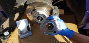

pcube said:
Possible to post the pic up here? I've got a dremel, but wanna see if it's within my skill level to do the trimming.
