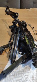

I bought complete roof framework parts with the "Hydraulic cylinder, roof shell" still attached, partno 54377223333/54377223334, from scrapyard.
Removed the cylinders and today replaced them on the car, swine of a job really hard to get at the clips due to access.

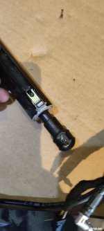

Remove the clips at either end of the cylinder, there is an electrical connector on the driver side only
Slide out the sliver tabs holding the hydraulic lines in and remove the lines, no fluid spilled
Replace in reverse, using new O rings, RobbiZ4 advised these earlier in this thread.

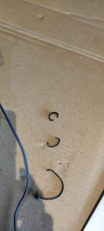

Getting the spring clips back in is really hard, i managed it by locating against the cylinder and pushing with a large flat bladed screwdriver, relieved to hear them click home. The clips are easily stretched on the way out and this could be a problem for replacement. I had the spare clips off the scrap unit so was ok. See pic showing small and large clip, the large should be the same, it is totally out of shape.
