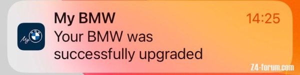

I drove mine for about a mile today. When I pulled back into the drive it asked me if I wanted to do the update. Told me to put it in park then I could exit and lock the car. About 15/20 mins later I got a push notification from the my BMW app saying it was complete :thumbsup:
