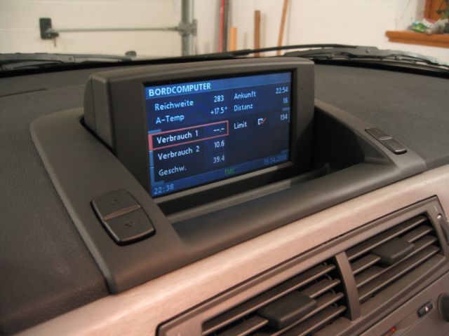

frcac said:
Finally got some time & peace to do it. Marked with the help of original cutting template with some diagonal references, just to check the position and symmetry. Since I got a feeling that the cutout on the template is a little too big, I opted out to make a slightly narrower cut - 6 mm according to my measurements. I was correct... I am not saying that the template supplied is oversized or not correct, I just felt comfortabler doing it this way.
... interior does look "complete" now, I think that the navigation really adds to the final image of the car.
Well, it was worth it. The last part - installation of the monitor - was quite a stresfull job with a lot of "what ifs". But I'm glad I did it 8)
Thanks for looking and for input when needed :D Have a nice evening, Saso
did you fit the grey display or is it a black one? i just bought one in grey and hopefully it looks like yours...
I had this same problem, in all the pics the black displays look grey, but when you get the display in person they are very much black. I was going to buy a used grey display off ebay and some members convinced me otherwise....bc i have black dashtop..... :wink:
I just received the cid today, it is in grey with black buttons- but i think it fits well to my interior - otherwise I'll respray it in black.
