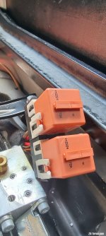

I did a relay change today.
I was wondering if anyone can see if the old relays look bad?
They look all ok to me.
Still, it’s for piece of mind!

Ah great, thanks Robbie.
The date code from the picture is 2136, that is week 36 in 2021, less than a year old. What should we see? The risk of a destroyed hydraulic pump arises after 5-10 years.
That is critical:
The 2136 is the new one I put in.
Previous were 1202. (Original to the car)
