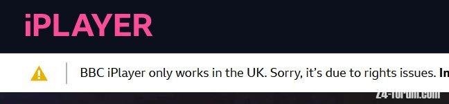

Robbi..not sure if you have seen the UK TV program 'Master Mind' https://www.bbc.co.uk/programmes/b006mk1s
You should do the 20 questions on ' The life and times of the E89 Roof System' :thumbsup:
Not yet.
But would be an option if you could organize a meeting with all my minions this year. :rofl:
