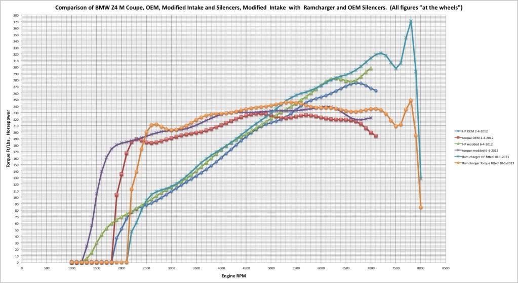

You might like to see where I'm up to with performance improvements from the mods that I've done to my Z4MC, as shown in the graph below.
I've compared the performance in 3 different states: 1. OEM intake and OEM silencers; 2. modified air intake and modified silencers and 3. "Ramcharger" and OEM silencers. These figures are "standardised" because, when recorded, they take into account the variables of ambient temperature, pressure and humidity, and all recordings are from on the same private road.
As you can see, I've been able to increase the torque output by around 8.5% above OEM, which in turn, increases horsepower. My latest mod, the "Ramcharger", not only increases the torque, but it also maintains the increased torque to high rpm, which has a considerable impact on bhp. I've previously made a "Ramcharger" for my Z3MC with the same S54 engine, and the results that I've obtained with both my Z3MC and Z4MC are very similar, except that the redline on the Z4MC is higher than for the Z3MC, so the Z4M is able to produce higher bhp. The dip and peak at around 7500rpm in the graph for the "Ramcharger" occurs because I had to lift off as I crested a small rise during the run, but shows that peak torque can occur at high rpm due to the effectiveness of the intake.
if/when I make this development available, then I have loads of data that would be made available to support the product. What do you think gains of the order shown in my graph, combined with an improved induction sound, would be worth?
im on a netbook so the graph is a bittt small.....
how much of an increase of bhp/tq is there....
it looks about 10bhp but as i say i cant read the axis
The "at the wheels" figures are Torque = 246lbs/ft and Power = 370bhp. You can add your own percentage to get "at the flywheel" figures as given on static dynos. I know some people will claim I'm a fantasist with these figures, but my DashDyno recordings give very similar figures to the dynos of Evolve and Powerstation. I repeat: the high bhp figure is due to maintaining the torque throughout the rev range to the limit.
Below is a dyno plot of my Z3MC with modified air-intake and gutted silencers on the Powerstation dyno for comparison. With my "Ramcharger" mod it does even better.

According to the information given to my datalogger by my Z4MC's ECU, it's around 8.5% peak torque and considerably more bhp.
So, what do you think such a mod is worth? The reason I ask is because I can develop this in a few different ways and I'd like to make it affordable, but at the same time, make it as aesthetic and desirable as possible. You wouldn't believe some of the old junk that I've used in my experiments in developing this idea - Blue Peter meets Scrapheap Challenge. :rofl: :driving:
