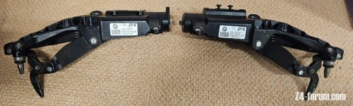

It was while using the key that the problem arose. Looking at Usel's pictures of the claws and given that the drive shafts turn freely I'm wondering if the screwed shaft in the latch mechanism has become detached somehow.

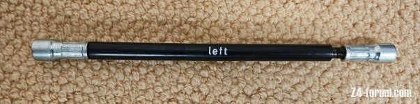

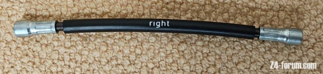

Just looked (with an endoscope) through the gap between the latch motor and claw assembly - there is clearly an issue with the drive shafts and they'll need to be replaced. Anybody got part numbers for these?
Just found this thread from 2017 - https://z4-forum.com/forum/viewtopic.php?t=101866
54347043871 & 54347043872
