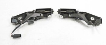

can anyone tell me what the box in the top of the picture is? Is it the sensor for the latch, or is it attached to the cable that turns the lock?
I dont know what that latch is Daryl but I dont think its for your 2003.
I fixed my latches last week and posted somepics: https://z4-forum.com/forum/viewtopic.php?t=132420
The motor gearing turns the metal connecting cable which in turn spins the latch mechanism.
Sounds like one latch is seized or its reached fully open / closed.
