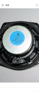

B21 said:Stealth00 said:B21 said:Please note..DO NOT use 6.5” woofers…they are too tight for the mount / holes…you can fit them but it’s a lot of messing around…6” straightforward..
Damn it, it took me ages to find the ones I wantednot sure they do a 6" version.
So, is it the depth that's the issue or the actual mounting point?
The outer edge of the speaker mount clash with the 4 screw holes for the BMW mount..it will require a bit of messing around..I found out the hard way on the 35is..I use Fosgate Punch 6" woofer on my 20i..to good effect
I'm struggling find a set of 6" speakers I want (I said I'm fussy). How difficult is it to work around the speaker mount issue?
