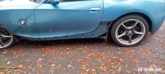

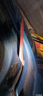

I’m going to refit the standard side skirts- any advice on how to do this?
Remove the fasteners in the wheel arches, remove the retaining bolts underneath. Remove the fasteners underneath the skirt. The only thing holding them on now are the clips along the upper interior side and the two plastic clips on the rear fender and front arch. Prise these off (take a bit of force) and pull the skirt away from the car.
Fitting is the opposite: first push the skirt home with the male-female fasteners, then align front and rear and reseat in the carriers on the body panels. Tip: put both the male and female part of the fasteners on the skirt, align with the body holes and push. Replace these for new when you do, the old ones often are past their best.
Refit lower fasteners, wheel wells and admire your handiwork :thumbsup:
Remove the old ones first! Two threaded 8 mm screws, one in the front wheel arch and the other underneath the sill towards the rear. Then remove about 8 pop rivets under the sill. From the rear pull the sill away towards you, I used a trim separator. Move the instrument along to the front slowly prising the sill away
