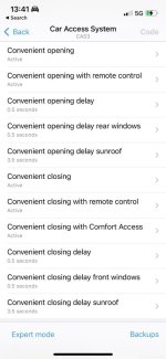

You can set the delay needed to hold the lock button that activates the folding mirror - I have mine set to 0.5 seconds (half a second).
There is no delay on unlock - it is instant.
These options are in the standard screen (not the expert mode) & can be set individually for the mirrors / windows / roof.

I'd need to check in the car, but I set everything active that was related to convenient open/close - you want the options for remote - the standard ones are for key opening, I think

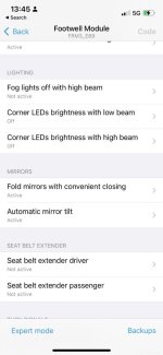

Here are screenshots of all the main settings on my car from BimmerCode. Note there is one in the Footwell Module as well as the obvious ones in Comfort Access System.

Finally sorted
It was the footwell module that I was missing
Works straight away now
