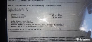

I have an issue with what I think is central locking related. When I lock the car after 30 or so seconds, I get a click noise which is probably normal but this repeats like the car isn’t going to sleep as you’d expect. This is confirmed by the red LED on the handbrake switch, light goes out but comes back on after a second or so.
I think the issue to with my passenger side door lock actuator as I’m also getting an occasional failure with the window not dropping every time when opening the door and one instance of a door open warning.
Has anybody had similar issues – is there anyway to diagnose without replacing the lock actuator?
