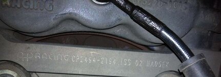

Last week my car was on a bridge an I took some pictures of the AP calipers to check if the numbers are indeed correct. On the rear there are no numbers. On the front I found these numbers on the back of the calipers (CP 5270-101C)
Can anyone confirm these are the correct numbers for the Z4M? On the AP racing site is says the following for the Z4M. Front: CP 5575-1010BK.G8 / Rear: CP 5144-1004.G8
I know playalistic had the AP kit but he doesn't have the car any more. Beedub also has an AP kit but i'm not sure if it's the proper Z4M kit, i think he's got larger rotors.
Also looking at the website.... Your part number seems wrong?? Either way the z4m and m3 kits are the same bar the choice of the thicker caliper and larger rotor.

So you have the same kit as intended for the E46 M3. Your front CSL wheels, don't fit without spacers. I can remember this from another topic. I already sent a email to AP with my question.
Indeed! That is what worries me... I was thinking the number would be on the caliper. On my boxes in were the AP calipers and rotors are delivered the numbers are exactly the same as on the AP website. On the box it says the fronts are Z4M and the rears are e46 M3 (which is how it's suppose to be).

Reply from AP, considering the numbers...
AP said:
Part # CP5270-101C is the casting # used in the mounting half for caliper assemblies CP5575-802S4 (RH) & CP5575-803S4 (LH). You would need to remove the caliper from the mounting bracket to see these numbers etched onto the caliper between the mounting holes. But no real need to do this because I can confirm from the photos that Bracket # CP2494-2194 ISS 02 HA05EK is a genuine APR UK part # used in brakekit # CP5575-1010BK.G8: - Is the front brake kit for BMW Z4M.
Franzino said:
Ther you go :-)
