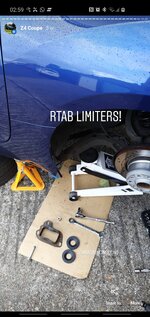

I thought about poly-bushing the RTAs but after inspecting my bushes and realising they were in perfect condition, I decided not to and ordered some limiters instead. After reading many forum people saying how much of a difference they made to the rear end, I'm disappointed to say that this is the cheapest mod here and the one I wouldn't recommend. Made f*ck all difference to the rear end. I believe they only felt any difference because of the alignment that got done afterwards or because their bushes weren't in great condition. Or because I have so many other mods, it's effect is just not noticeable.

Interesting point re. the RTABs. I suspect limiters can compensate for soggy bushes. Mine were absolute mush when I replaced them (along with a million other things), so none the wiser. I bet some also get shredded quite quickly due to lack of preload.

Thank you! x3 It was one miserable, uninteresting job. Honestly felt like putting a dunce hat for paying £50 on 4 pieces of turned plastic. The company doesn't even machine a lead-in chamfer to make fitting those easier, so after sanding the edges to create a chamfer it was much easier to install.
