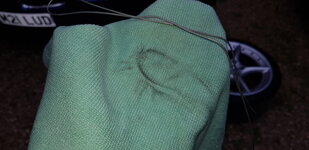

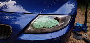

Removed the projectors again and cleaned inside the headlights, they're noticeably cleaner now. I'll be collaborating with a UK company to improve the fitment of Morimoto projectos on E85/E86s and offer a kit with a forum discount (not gaining anything from this other than lights I can really upon, OEM xenons are useless and I won't be entitled to the discount, I don't want to be biased).
The headlights look really shiny now, before they looked a bit dull even though I had refurb'ed them. Some weird imperfections that I did not managed to remove when refurbishing the headlights were actually dust gathered together inside the headlights. I recommend doing this to yours. I'm still unhappy with OEM xenons though, even after spending £80 on the best bulbs you can buy from Osram

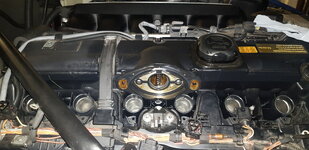

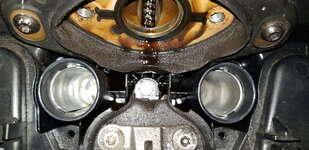

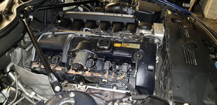

Finally changed my Valvetronic motor gasket - a job I was putting off as I knew once I removed it, I would spend ages cleaning all the oil residue under it. Once it was out it was quite obvious it had been the culprit of the oil leak on my engine (it was hard to tell when I bought the car due to the filthy engine).
New gasket in:

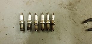

This job nicely tied in with changing the spark plugs and inspection of the coil packs (previous owner changed them recently, so they were in perfect condition barely showing any sign of being used). Plugs looked rough, which I expected as the engine ran in emergency mode for a good few thousand miles due to a faulty lambda sensor (which I changed in my 2nd week of ownership).

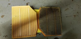

If you buy a car from London, change its filters ASAP!

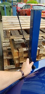

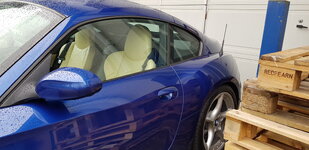

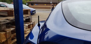

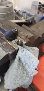

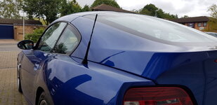

I'm not a fan of the whippy, but similarly I don't like the stubby very much - that said, I would rather have a stubby if I forced to choose between the two. Since I took all the boot trim apart to get to the top mount nuts, I removed the aerial base to try and remove the seized whippy.
Lots of penetrating fluid and brute force (thoughtfully applied to not break the aerial stud inside the base) later, I managed to remove the whippy.
Then I order a stubby and a 'small whippy' to see which I liked best. I ended up preferring the small whippy, doesn't look daft as the OEM aerial while not looking like I want to be part of the cool kids (no idea how to put it). I would like to hear your thoughts :popcorn:
I might still give a stubby another try, but for now, I'm happy with what's there. Radio reception still excellent, just like before - and just like before I will not listen to ads, I mean radio.
Hmm - that shorter whippy looks pretty good. :thumbsup:
And it will make for a different point of view in the regular stubby v whippy "debates". :lol:
I don't know, I think they're fanatics haha
Here's a link for the shorter whippy (£9 on Amazon Prime):
https://www.amazon.co.uk/gp/product/B075P2TS4Q/ref=ppx_yo_dt_b_asin_title_o02_s01?ie=UTF8&psc=1

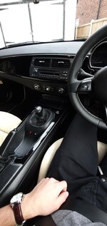

I think the exterior and mechanically the car has been up to my standards for a long time, and that can be seen in photos in this thread. But the interior lacked perfection, the steering wheel (and its trim) had a lot of wear marks and some of the trim was not in a state I would be happy with, so needless to say I've spent a few hundred making sure I brought the interior to my standards.
Starting with the centre console, I bought some parts from forum members that were in better condition than mine, and had to order some from BMW at a rather hefty cost:
Old vs new. £30 :cry:

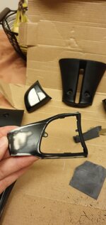

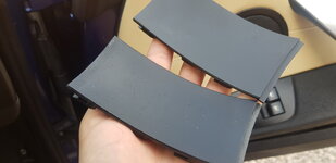

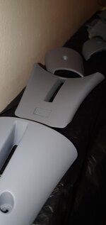

Then the steering wheel... I spent a weekend refurb'ing the steering wheel trim and the following Monday drove (trimless) to Royal Steering Wheel to get put the newly refurb'ed trim into a newly re-trimmed steering wheel.

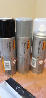

Products used:
Sanded with 800, 1200, 1500
3 coatings of Primer
3 coatings of paint and two of lacquer then 12hrs of curing on the heater
Final result (bad photo):
Interior with new centre console trim, refurbed steering wheel and a custom shortened gaiter to match the steering wheel (i.e champagne stitching):
I love my car's interior even more now.
