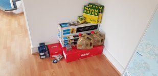

I haven't been doing much work on the car as I'm waiting until I get all the parts I've been ordering to do many things in one go. But looking at the pile of parts on my desk that have already arrived, I decided to change the cabin filter ASAP because the service history shows it's been a long time since its been replace and the car was mostly in London for that entire time.
It was the most disgusting cabin filter I've ever replaced. The brainless monkey that BMW hired managed to put the filter the wrong way around lol
Old vs New (the other side of the filter was even filthier):
So much crap fell out of the filter housing:
I used a very nice product to 'clean' the HVAC system. Very pleasant 'fresh' smell, and not strong at all - ideal!
https://www.cleanyourcar.co.uk/sonax-tropical-sun-air-conditioning-cleaner
Now that the filter is no longer clogged with filth, I can feel the air conditioning blows more effectively (more air, less noise).
