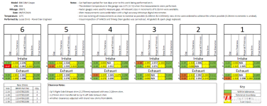

Checking the valve clearances and shimming them was quite fun. A bit annoying that they are only available in 40µm increments, so couldn't get all to nominal, unfortunately. I measured all shims and then ordered what I thought was best - check summary sheet for details if interested.

While there I had a good ol' look at the Vanos oil pump hub and timing guides, going as far as looking at the details with a borescope. All in good condition, so I will enjoy the car for this summer before doing some preventative maintenance on the VANOS and guides.
