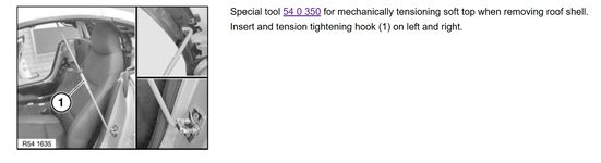

So as to not break all of the headlining clips (or worse damage the headlining) there is a special tool, 5 10 310
And the process (as above)....

Some photos that may be of help :thumbsup:
