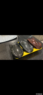

Dave, have you done your roll bar hoops by any chance?
I’m wondering if a gloss Carbon effect is do-able?
I did do my roll hoops ( in gloss black ) this was before I’d started with the hydro dip . I wish I’d known about it before I did them . Doing the hoops in gloss black was difficult to get the wet look effect in those bends without runs or overspray . With the hydro dip the paint doesn’t have to have that effect, as long as your colour has covered the part . It’s just for the print to stick to . The thing with dipping those is the shape. You will likely get a bit of stretch in the pattern.
It obviously has to bend round the shape so won’t look straight all through. If you look at the pictures of the speed shapes you can see what I mean. Although I’d expect the hoops to come out better than those speedshapes .
Let me know your thoughts
There is a thread on carbon hoops in the e89 I’ve just noticed. They would come out something like in the hose pictures but a hell of a lot cheaper. Depends if the individual wants real carbon. I did put a carbon steering wheel on mine . So I’m not against it . 😂
I can see a ‘wobble’, for want of a better expression, in the darkest finish, but the other two look pretty good for so many curves :thumbsup:

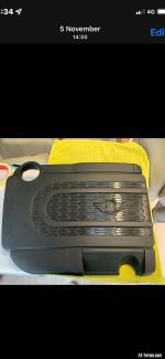

But managed to get Eileen’s mini engine bay cover finished today ( one of two )
Here’s how it turned out 695086EB-E5F1-4DC7-A5B3-15A232D4241D.png75657A03-6A79-4711-BE1C-B91253A90D37.jpeg
