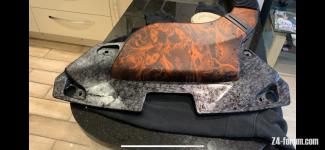

Did the front of the slam panel in forge carbon.
It’s still wet from the rinse in the picture.
I’ll clear coat in full gloss on that part tomorrow BE092A64-E475-4305-A187-7B7E4FCC966E.png

Is it possible to add decals on top of the dipped parts before clear coat?
Yes griffo46
You can put another hydro film over the first one
( double dip ) I also see liquid concepts did a Maserati bonnet interior in red candy carbon with the Maserati logo in gold … it looked stunning. I’m hoping to do something on the inside of the bonnet myself at some point

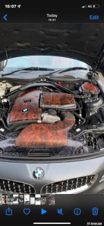

What kind of container did you use for those large parts? a bathtub? Paddling pool for smaller bits
But yes … bath tub for the slam panel and rocker cover

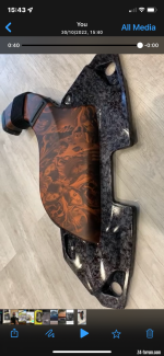

Just finished the clear gloss clear coat on the carbon . I’ll leave it at least a couple of days before it goes back on the engine C2B6B2DE-A9C5-44BC-877F-9A0E783FA7B5.png
Front panel back on the car .

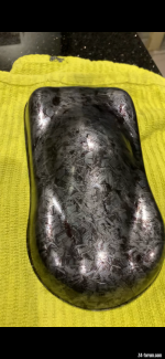

I intend to forge carbon dip the strut brace the same as the front panel .
Just waiting for it to be delivered
Not sure about rich πŸ˜‚ I intend to keep the pricing low compared to some of the outrageous quotes I had . After seeing the carbon mirror covers thread , I’d best get a pair done and put them on here πŸ˜‚

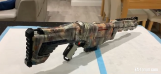

Did my mates boy’s nerf gun in camo to see how it turned out …..
