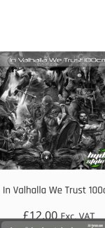

I just ordered this as a possible central peace for under the bonnet where the noise carpet is
Come back to me if you find something you like. And if you want me to do the work, the company I use for paint and film is hydro style uk . They will work with you and help you get what you want regarding a bespoke film . They too obviously will do the work for you… but Dave ( davros ) had a crazy quote from them when he asked. Just trying to be as transparent as possible
