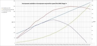

If you look at the graph your car (broadly same as mine) and the power curves then at around 120 mph you need about 100 wheel bhp and at 4,000 rpm ish you have over 200 wheel bhp spare..so your car will accelerate from 120 like a 200 bhp car would from rest..(for a while)
You are just coming off the peak of the torque curve so all the stars align..that's why a 35is is such a great motorway blaster.. :driving:

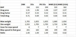

sars, here is the normalised data as best as I can do it.
Few comments /observations..
I've included the US version of the M40i to see how the extra BHP affects the calcs, and on my 35is as well as the BHP increase I've used flybobbie post on aerodynamic devices to reduce my drag factor...on there model which had a drag factor of 0.3441 which is in the Z4 ball park, the spoiler and diffuser had a reduction from 0.3441 to 0.2872 ie 0.05 reduction..I've taken a 0.03 reduction for less than perfection.
Interesting that the M40i has the same spoiler and diffuser design, more or less.
Also my wheels / tyres are 1.9% larger hence higher theoretical top speed.
I've assumed transmission losses are equal..in theory the Z4M manual box and the 35is DCT box should be close and they are both in direct drive, the Z40M is in 7th which is in-direct so in theory there should be a little extra transmission loss.
Weight is required for my rolling resistance calculations..I've taken GVW and subtracted 150kg for no passenger and luggage (also addresses the options as they are not often factored into the empty weight calcs)
Over to you!
There's a link to an excel spreasheet here..
https://www.dropbox.com/s/ykl3hkkrut8rxyn/Another%20speed%20calculator.xlsx?dl=0

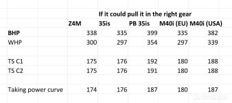

I found a couple more accurate calculators and I then took some dyno runs of N54 powered cars that did both crank and wheel hp, so used these correction factors..the results are here..
I took into account the gearing, the best gear to do the job and the actual power curve to determine both the theory if yiy ignored these issues and the most likely realistic outcome if you did enjoy.. :thumbsup: :
So obviously all ridiculous speeds although I did find a EU spec M40i that was mosselman tuned hitting 180mph pretty effortlessly on YouTube.
It does look like a supercharged Z4M or a more aggressively tuned M40i will take the honours…the 35is hasn’t got the gearing on these turbos to do much more, it’s running over the peak. We will have to wait to see how the TTE500s do, if they allow it to rev to close to the red line then it could give a supercharged M or a tweaked M40i a run..but at the moment on the Forum I think the supercharged M will be topdog :driving: :driving: :driving: :thumbsup: :thumbsup:
