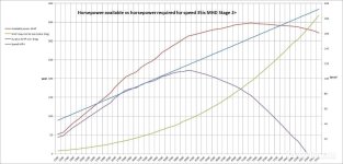

Inspired by the discussion of the orginal post, I've been ruminating away to try and bottom out the question in the absence of a (at least) 3 mile flat straight road.
There is a web site that gives a pretty good crack at it for non modified cars.
https://www.automobile-catalog.com/car/2015/1861385/bmw_z4_sdrive35is.html
Also from a purely theoretical viewpoint I was intrigued to see how re-mapping and/or re-turbo-ing a car would affect its performance.
Sadly I've not been able to find (maybe I'm not so hot on Google after all) a program /website that allows you to answer this question.
The problem is complicated by several factors..
Most modern turbo cars run out of puff before they hit the redline
Several cars have overdrive higher gears.
So I took data from published sources for the drag factors, used a wheel horse power to drag calculator to determine the bhp required for a certain speed and plotted it all out..enjoy!
Here's a dropbox link for anyone wishing to look at the workings.. and a better copy of the image
https://www.dropbox.com/s/x1dq3f3au8ggdv2/35is%20top%20speed%20predictor.jpg?dl=0
https://www.dropbox.com/s/u8uwwos0xqisgtd/35is%20speed%20calculator.xlsx?dl=0
Approx (weight is less so has a small improving effect)
240 bhp buys you about 157-160 mph...as you can see from the graph you are entering the zone where it's taking a lot more BHP to get anywhere..at the change from 59-61 mph takes 2 bhp, from 154 to 157 takes 7 bhp
That's assuming the gearing and BHP shape work for you.. :driving: :thumbsup:

Quite so, sounds like a 'fact'..more interesting is that say at 155 mph the wind shifts for 10 mph tail to 10 mph head wind (nobody ever checks the wind strength and direction on these high speed runs) then you needed 163 rear wheel horsepower and now you need 228 of those ponies.. :driving: :tumbleweed: :thumbsup:
All these numbers are superalitives..wing mirrors in, tape over the door seals etc...

Forgive me if I've misinterpreted the graph, but is that estimating top speed, for your output, of 185-190mph?
Basic physics if it takes 100hp to hit 100mph, it will take 400hp to hit 200mph.
So 350hp won't hit 200mph.
My 23i i believe limited to 155mph, be surprised it would go that fast, perhaps heading south with a tailwind it might.
In this model 183-185 mph is the prediction based on the declining power curve past peak versus increasing drag curve :driving:
This model shows circa 58 BHP for 100 and 420 BHP for 200 mph (at the wheels)…unlike an aircraft you have a rolling resistance component as well.. :tumbleweed:
Your 23i BMW says 151mph ..this model says about 151 mph… :driving: :thumbsup:
