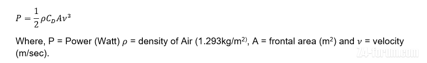

So I've had a little time during a wet lunch to put pen to paper and reacquaint myself to Massey, Bernoulli and Mr Watt! When B21 put the above graph together I thought he's got an answer after a fashion and in a round about way, so: -
This is an amalgamation of two well known formulae derived from Bernoulli and Watt, there are limitations to the theory based on low Reynolds number, where inertia of the fluid is ignored, but for our Zeds it's simple enough. Though it does ignore rolling resistance, friction of bearings etcetera.
For my car the theoretical top speed not limited by gearing with a Cd of 0.35, frontal area of 2.2 m2 and 250kW, is 79 m/s or 178 mph :thumbsup:

Splendid..the sim suggests 175mph..now that you are on a roll could you do a time, distance to top speed model please ? :thumbsup:
