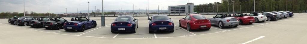

The location where he has done so many Z4M was at my restaurant where we had the meeting last year.
You guys will enjoy the m track mode.
All questions were answered truly.
Not all cars that were there that day are on those photos.
They were many many more.
