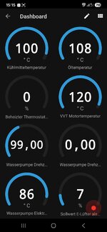

Currently I'm using it on a daily basis on my E61 for live monitoring cooling parameters, which individually can be arranged as dashbord on the mobile (iOS, Android).
Have a look:
Clear recommendation of BimmerLink for monitoring, registering, resetting service data and reading fault codes.
