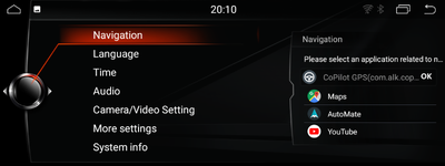

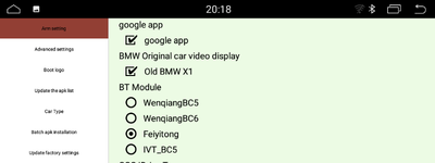

As for "No Signal" go back a couple of pages and I've shown some screenshots.
Go to settings, More Settings...
file.php
Then scroll down to BMW Car Original Video Display...
file.php
And tick Old BMW X1

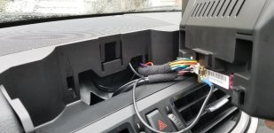

A small but irritating one: a piece of the screen protection wrap got stuck in a corner and can't get it out. (tip for new installs: carefully remove the screen protection, or better yet do it before finishing the install, in case it doesn't come off entirely
If you tilt the screen forward, it will release from the base and you can pull the screen out of the base entirely. This should allow you to remove the remaining plastic.
Wow, didn't know one can do that :D Thanks!
I tried, but couldn't move it. I tried with quite a bit of force. It feel like if I try harder I will break the whole thing. Thanks for the tip, but I'm not going to risk it, I can live with the piece of plastic in the corner :)
Mine comes out easily so I took a closer look. The screen fits into two slots on the back. You should be able to pull straight up and THEN tilt forward to remove. 15575198959351584832043285283069.jpg
There is a security sticker on the back that if you break then you will void any warranty.
I do not recommend pulling the screen out like this. :?
