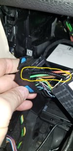

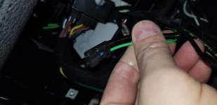

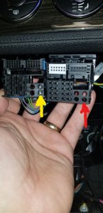

I figured out the "heart beat" noise coming from the speakers. It was coming from the professional stereo. I noticed a red light flashing on the back of the unit while checking connections. The red light was flashing in rhythm with the beats from the speakers. Turns out there's two fiber optic cables that need to be moved to the new head unit connector. As soon as I connected them back into the head unit, the noise went away. Adding some images.
I take it you didn't spot that comment on my installation video? :thumbsup:
Glad you've found your problem though.

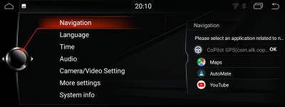

Finally, someone helped to install mine. I wasn't with him when he's installing it.
The head unit and reverse fit nicely. The display is very good and sharp, easy to maneuver the menu using the added iDrive console. (Note mine doesn't have original iDrive)
However few things happened i.e.
Things that work
1. Yes my phone connected using bluetooth in the head unit.
2. These buttons on the iDrive work fine: Tel, Map, Back, Option, and Knob button
3. Music/Video can only be controlled via the screen menu (using Knob on iDrive & touch screen), then need to switch to aux mode on the radio console
Thinks that changes/no longer work:
1. the bluetooth phone connection facility on the radio console disappeared, presumably switched over to the head unit.
2. The phone button on the steering wheel as well as on the front panel of the radio console does not work if you want to initiate a call but can be used to receive a call
3. The ringtone is very loud and I don't know to turn it down, tried to adjust this via setting and audio setting both fail. If I turned down the call volume in the audio setting it does turn the ringer tone down but then I hardly hear the voice during the conversation.
4. These button on iDrive does not work: Radio and Media
The reverse camera that I bought via a-carnavi fit nicely and work fine, see photo attached.

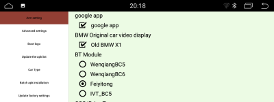

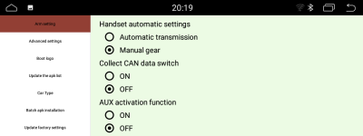

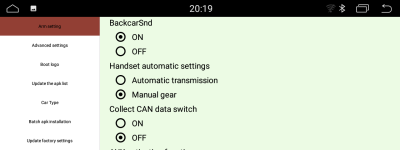

Eko,
Let's help you sort these issues out.....

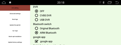

1. To use the cars original Bluetooth then you need to set the setting to "Original Bluetooth"
2. & 3, should then work fine
4. Yeah in non-iDrive cars these are non-operative as they refer to iDrive operations.

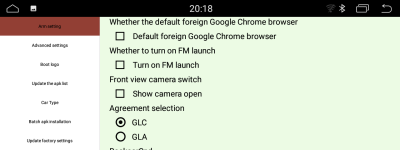

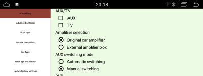

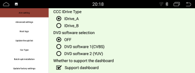

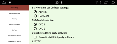

I've attached screenshots of my set-up for the ARM settings screen (I have non-iDrive and manual)Screenshot_20190425-201810.png
I have available both OEM bluetooth and Android bluetooth available but as a rule I don't use the Android bluetooth as if I want streaming music I use either my cable connected Android Auto or or WiFi Hotspot to the screen and use the appropriate app (Apple Music, Spotify etc).

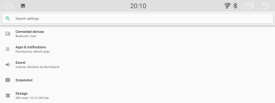

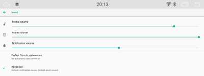

As for incoming ringtone volume...
Go to "More Settings"..
And then scroll down to "Sound"...
...... next post.......
From there go down to "Notification Volume" and adjust this accordingly...
This should sort the ringtome out without affecting voice volume. :thumbsup:

Thanks Dave,
Tried to adjust the volume in that "Sound" option, it did work but after I restarted they back again to max. Not sure why that happened, only the "Notification" volume that does not go back to the full bar. It seems mine behaving differently.
